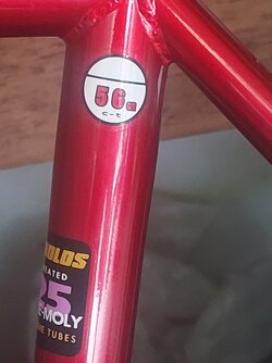

The bike is a 56cm and I'm 5ft 10 I've always had a 56cm so it's not the wrong frame size.

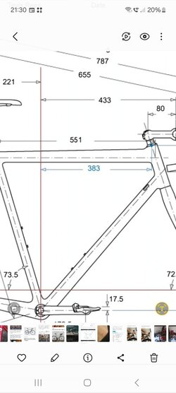

How's about offering us the distances of:
1) centre of BB to the point on the seat tube/post level with the head tube/top tube intersection and
2) from the head tube/top tube intersection point to the point level with it on the seat tube/post?
If you need the saddle that high (long legs) then the frame looks too small to me as you'll be doubled right over like a racer with the bars/hoods so low down. For your riding the hoods should be roughly level with the saddle.

where did you get the genesis from and have you checked the measurements ,? i am not saying its wrong but it does look small to me as i have been misold frames before now .Hard to tell without comparisons and i always end up on bikes that are on the large side of my sizing as im 5 foot 7

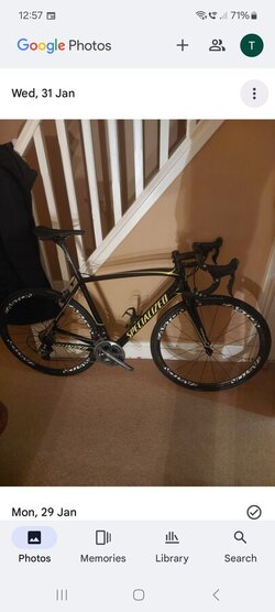

This was my current summer bike

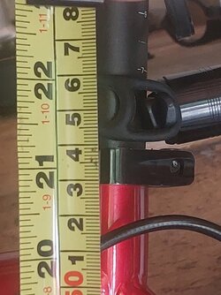

I've just checked for the first time it's says 56cm on the side but I measured and it's 54cm do you think that's why I've got to have such a big stack.

Your correct I've just measured the frame it says 56cm on the side but I measured and it54cm is that why my seat height has to be so high and the stem height. I would have thought the bike fitter would have picked that up.

I've just measured my racing bike same again I was told it was 56cm but just measured it's 54cm.
I may be wrong - you haven't provided a decent picture from the side of the whole bike against a plain background - but that 54cm is to the top of the seat tube. Is that point level with the head tube/top tube intersection?

I've messed up I've just goggled it because I've got a slopping tube you get a spirit level from your head tube go back then measure from the centre crank up to the level mark . I've stripped down my bike and have just started building my old dawes bike 😆

You've posted a lot and told us nothing.
Length of a virtual (horizontal) top tube tells us a lot more than a seat tube measurement, I still think the bike fit charlatan needs shooting.
Are you really inflexible, is that why they have put the bars so high?

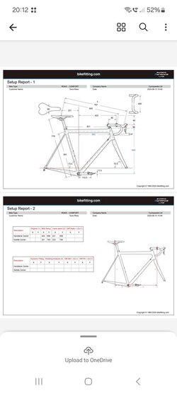

I did post the measurements of the bike fit on earlier post I think anyway here it is.

ask yourself " does the front of your bike 'post fit' look anything like this?"
then ask bike-fit-charlatan man why not
