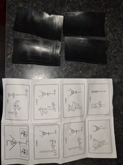

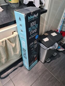

Edit - I was only assembling the bike stand today and learning how to use it. I didn't put my bike on it. I didn't even bring my bike out of the garage.
I got this stand:
https://www.halfords.com/cycling/bike-maintenance/bike-work-stands/halfords-repair-stand-164412.html

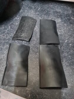

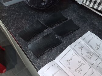

It has 4 rubber things inside the box. Instructions are hopeless.

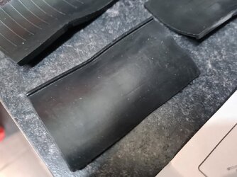

I thought the rubber things would go into the clamps to help secure the tubes and stop them from slipping.

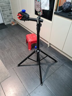

I tightened the blue knobs as tight as I dare to go, after having raised the top tube that has the bike holding clamp on it, then I put some body weight down on the clamp and the top tube slides a bit. So I'm not so sure this thing is safe to use. It might just slip under the weight of a bike.
So I figured the rubber things are to put in between the posts and the clamps to stop the slipping. But they don't fit. Not enough space between clamps and tubes.
I saw in a poor quality YouTube video, a guy used 1 or 2 of them to secure the tool tray.
I thought they might instead be for the top clamp that holds the bike. I thought they might go onto the 'teeth' to help hold the bike and prevent damage.
I'm clueless. And I don't like that all the tubes slip. Bottom one too.
Forgot to photograph the tool tray. I won't be using it anyway. Just using the stand to wash my bike and repair punctures.

Looks like a bog standard stand. The rubbers are maybe just to protect a carbon frame.

It's quite reasonable that if body weight is applied vertically to the stand, it will slip.
The stand is designed to support a bike (yours is 14.5kg) without slipping (plus design margin), not half a man's body weight (35kg): it will be fine.
Just tighten the blue knobs: hand tight.
Might the rubber bits go under the legs, to afford grip?

I have the same stand. I use the rubber pieces to protect the parts of the bike that I clamp to the stand - seat post or (very gently!) the top/seat tubes.
I've not had any slippage of any part of the stand itself, but I don't put my body weight on it, as that's way more than it needs to support.

Got an Aldi stand a while back, and would say it was at the cheaper scale of things, but perfectly adequate for occasional use. Anyways, similar to the one here the OP has.
I think that folk tend to have too high an expectation as to how firmly these type of stands can hold a bike. I sometimes clamp onto the seatpost, and naturally the weight of the bike is now unevenly distributed, so I put an old stool under the front wheel for additional support. Expecting the cheapo clamp to do the job itself is being a bit optimistic I think, and if you do manage to clamp securely, the threads/clamp are being over-tensioned.
Same for clamping in the middle of the frame. Fair enough, it will hold securely as the frame is balanced nicely. If I then remove the front wheel, I'll put the stool under the rear wheel, and same goes for the reverse of this. Makes sense to me.

Depends on the bike - you might want to clamp the seatpost.
If it's a carbon frame they don't like being compressed but the seatpost is designed for that.
