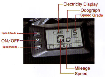

Interesting, how do you know 7%? My display
1654331215027.jpeg is rather lacking at saying how much left. On the right hand side I have a key and three LED lights, all three full battery and when last one goes off, the drive is disconnected, the two battery level indicators do give a bit of a warning as to when it will run out, but from one LED to no power there is really nothing to show how much left, the bar graph shown above seems to go up/down depending on how hard motor is working, so may show three bars going up hill and all 5 going down, right hand three LED is all three around 70/100%, two around 40/70% and one zero/40% so not that helpful.
