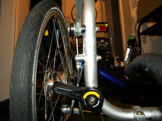

sunnyjim
have you any photos of this adaption as i am looking at changing my twisters and am looking for ideas. i have seen trikes with mountain bike shifters on which seem to work ok have also looked at bar end shifters. but i am still looking at present
many thanks
Pic attached. These are braze-on levers modifed to fit them with a long M5 screw right through the lever and handlebars. (Hole through the bars is OK, but obviously not what you'd do on a standard DF frame...). Collars for the cable are short lengths of SS bar again held by screws through the bars by M5 screws into tapped holes and cross drilled & countersunk to suit the cable inner & outer. I made these to include additional cable length adjusters as you can see on the pic, but the adjusters on the shifters should be enough.
The levers in N14's link to look like a ready-made solution (if a little pricey) . I hadn't seen them when I made my version.
I find the levers placed where I have them is convenient for shifting either with fingers or palm of hand. One quickly learns to keep fingers out of the wheel...
Gooey stuff on cable is white lithium grease to stop water getting in.
