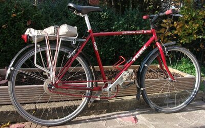

I converted an old steel-framed Basso into my SS. All I had to do was to take bits off and then I got hold of a load of spacers and took all but one sprocket off. A bit of trial and error gave me a perfect chainline. I used a 39 chainring with a 15 sprocket. Here's a picture of the end product.
And here's how I fixed the sprocket in place...
I did a test ride with the bike set up like that and the chain came off the sprocket twice in about 3 miles. I concluded that this was because cassette sprockets are designed for it to be easy for the chain to move up and down the cassette. Not so handy when there aren't any other sprockets...
So, I used a bit of lateral thinking and put bigger sprockets from the old cassette either side of the one I wanted to use (after the second photo was taken). They act as guards to stop the chain coming off. The bodge works perfectly. I've ridden hundreds of miles on the bike since then and the chain has never come off again.
Even though my SS has a steel frame/forks, it was surprisingly light once the redundant bits were taken off. I haven't weighed it but I'd guess it is about 19-20 pounds.
I can feel how much more efficient the perfect chainline and lack of jockey wheels makes the bike - it is really easy to spin those pedals round. The gear I chose is perfect for me at about 20 mph (cadence of 100 rpm). I start to spin out above 24 mph (120 rpm). It's okay on shortish hills up to 7% or so, but I don't like long ones or steep ones in that gear.

Did you use a chain tensioner or did your bike have horizontal drop outs, if so how do you find it?
I refer you to the photographs in my post above! ;)
3 of the 4 road bikes I've had in the past 20 years have had semi-horizontal dropouts and that is one of them. No chain tensioner required, just getting the number of links in the chain right.
If you look very carefully at the picture showing a close-up of one of the dropouts, you'll see that it has a screw adjuster to allow the position of the axle to be fine-tuned. I had to pull the wheel back another mm or so once the chain started to get run-in. The actual wear rate on the SS's chain seems to be very low because of the perfect chainline and because I've kept it very clean.

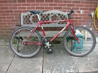

This one cost me £25 for the original bike. Binned the wheels and used some I had lying about. £15 for a sprocket and spacer kit. The chainset was a triple from my parts bin, I removed all the rings and bought a Surly stainless steel one for £30, expensive but hopefully it will love me long time. I bought a budget bb for about £7. Mudguards etc I would have to have bought for a geared bike any way. It gets me to work every day and has definitely paid for itself. SS does cost a bit to set up but then the maintainance costs are pretty low. I might treat the frame it to a powder coat in the spring after removing the gear cable guides and hanger.
You could try using one of the freewheel sprockets and the existing chain wheel like I did at first (see pic). This gave me an idea what the bike would ride like before I spent any money.
