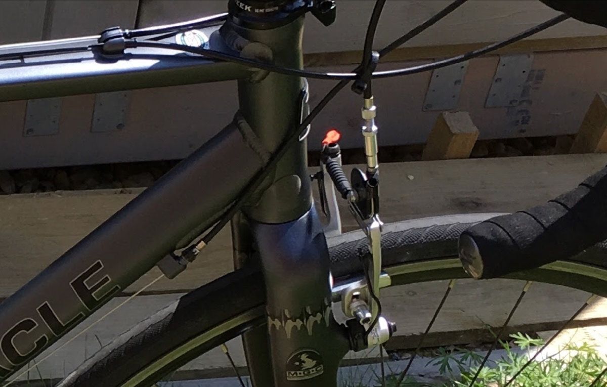

I noticed that the manual for the Tektro V-brakes supplied with my new bike back in January said that a front brake on the right lever needed a 135 degree noodle, rather than the 90 degree one that was on mine. I saw one on clearance for a couple of quid, and gave it a go. It seems to give a better cable line across the front, clearing the fork crown mounted light better. It's probably a better line for cable operation, too. Just food for thought.
