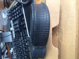

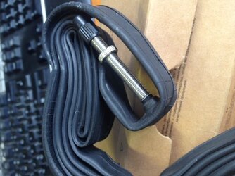

A couple of images to give you an idea of the quality

LOL! What did you expect?
