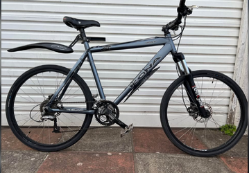

Hello everyone,
I am planning to buy a bike to enjoy Scotland's scenery. I would ride mostly away from busy roads, so would do lake rounds, woodlands at some point some casual ride hoping to get fit enough for some easy trails later on.
Im (193cm) 6'4 and 120kgs.
Looking to buy around 200-250gbp as a starter bike which can handle my weight. but its quite hard to find bikes in my size. I came across this Kona Hoss in my area. I saw its an older bike already. Would it still worth 180gbp? Or i should buy some newer? this is one of the XL frames is found. They say it has hydraulic brakes and its 3x9. I saw a Giant Roam 1 for 300 which is bit out of my budged, bit it was only L frame. Thank you in advance.

That does look well used. It is always tricky with such old bikes as it is hard to tell what made need to be spent on it parts and service wise.
I would say that the wheels look a bit basic and not the sturdiest. For a larger guy like yourself they make not be up to the task.

Thank you. Yes I thought so. I'll look around more. Cannondale trail 8,7,4 are around, maybe giant roamer 3 or wait for 1 to show up in XL. Giant tail too, Also there are trek Merlin 5 ,7 and some Cube bikes in this price point.

I think all MTB will have basic wheels.
I've seen bikes with rusty forks for £150... Cube behind others!
If the gears /brakes are working and still got life (chainrings should be flat topped not shark fins!)

120kg is no problem at all, and I don't really think aluminium fatigue is something to worry about. Maybe an aluminium frame will fail after a lot of service, but it won't turn brittle from lack of use. There's no reason to buy a bike which isn't in good condition and it seems you can't give bikes like a Kona Hoss away these days.
You might have issues with a suspension fork of that age that hasn't been used - I would say a rigid steel fork would be better. Dawes made a bike called the Sardar Flatbar while I was not paying attention - having seen one of these in the flesh I reckon it would be a perfect bike for a bigger person.
Wheels are the thing that will fail you most often if you weigh a lot. My "nice" bike has Rigida Sputniks, 36 hole, built onto a Deore LX rim. Thicker spokes on the drive side, and they were handbuilt. It costs more to get a handbuilt wheel, but it will last you - provided it's made well enough, you won't need to true your wheel or replace spokes unless you have an accident or something wears out. I don't think you can get Sputniks now, but Rigida makes the Andra which is a stronger rim. Don't go too skinny with tyres - 26 x 1.75 is a good width for a "slick" tyre for road use on an MTB. Knobbly tyres will give you a better workout on tarmac or a cycle path, but if you're riding to get anywhere you'll find slicks better. For use on mud, knobblies of course.
Then, you have to make sure the contact points (pedal, sadlle and handlebars) are in the right place. If it is uncomfortable, you won't use it.

To clarify my point, aluminium fatigue Is not something to worry about with a frame, provided it is in good condition. If it was a superlight racing bike then maybe not, but the Hoss isn't one of those. The Hoss is massively overbuilt.

I personally don't think the Kona Hoss was massively overbuilt but definitely overbuilt but have seen stronger hardtails.
Bikes designed for different disciplines of riding need a different design. The Saracen Xile you mentioned above was a dirt jump bike. It was marketed at kids who wanted to spend hours jumping off unsuitable things. Of course it would be stronger than a bike designed for cross country. I am surprised that someone who obviously spends so much time thinking about bikes hasn't considered this.
The Hoss was supposed to be an XC bike for heavier riders - see the Wayback Machine description of it from Kona's website here. A stronger frame than an XC bike (look at those massive square tubes!) and a much more forgiving riding position than any of its contemporaries. A heavy rider could well have damaged a lighter XC frame, and they would likely have found it uncomfortable in any case.
There will be plenty of examples of unused bikes out there - the road to hell is paved with good intentions. If OP can find one, a Hoss will be a good choice with the parts that were specified by the manufacturer - it was designed for a heavier rider who probably has less bike fitness. It's much more upright than an XC bike from the same period.
As to weight limits on modern MTBs - I strongly suspect the figure is pretty arbitrary, specified by the warranty department as much as design. You just don't hear of big people breaking mid-range bike frames very often - superlight stuff maybe, but that's not what we're discussing here.
Wheels fail, in the most part. This is because they're not usually not specced properly, and built by machine. Partly it's rider weight and distribution between front and back wheels, partly because inexperienced riders don't learn to unweight themselves over the bike when they go over potholes. In either case, this can be mitigated by choosing appropriate components. 36 spokes on the rear wheel, stronger spokes on the cassette side and stress relief and retensioning before the bike gets ridden on.
