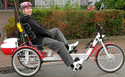

Here's the beauty in her home land Germany just built
my tyres are 22 inch 15/8 do they make Schwalbe marathon or marathon plus in this size as I'm struggling to find them?

I suppose one answer might be Green Tyres They don't appear to make a 22" bicycle tytre, but they do do 22" wheelchair tyres. They are used a lot on wheelchairs, where a puncture would be an obvious problem for the user.

I hadn't thought to look at wheelchair sizes. If it is one of these that has been used then there is a 22" Schwalbe Marathon Plus available. LINK
The ETRTO size would still be helpful to confirm it's the right size (there appear to be different versions of 22").
