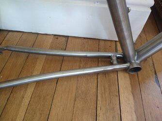

Have you explored a repair @AlanW ? You obviously need a specialist welder with the right kit, but there are people out there doing Ti repairs, just a question of finding someone local-ish . Once welded properly it will be good and strong as new and likely to be the cheapest option for you.

I can weld titanium and have done before.Alans frame hasn't gone at a weld...more like a stress crack which is different.I could put a decent enough weld on that crack or put a sleeve round it and weld that up.But I'm not 100% sure I'd trust that frame afterwards,close enough to another weld aswell to be putting so much heat through it by welding.Probally a safer bet to take the money and get rid

I had my 7yr old Qoroz fixed TI frame repaired by Ted James. He builds steel & Ti frames. He was going to replace both chainstays but, for reasons, opted to sleeve them instead. The stays had been heavily ovalised for clearance - probably allowing too much flex with fixed riding. Ted's made a neat job and dealt with the design fault. £200.
