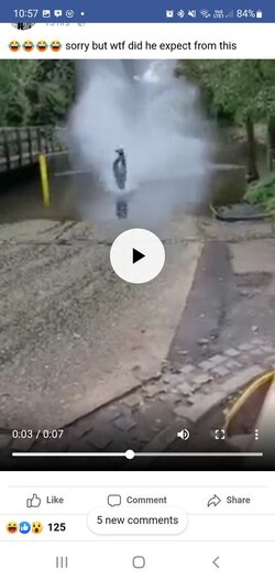

Have a look at this video of Kenilworth ford in flood, from 1m12 to 2m43 there's a 4x4 driving through it.
It's 3 feet deep, which you'd think might be enough to float it, but hey, it's got a snorkel so it's obviously designed for this sort of stuff. Isn't it? Well watch him open the door at the far side and empty all the water out.
So there's no point in the snorkel then, just a marketing gimmick designed to appeal to the sort who think it looks cool.
If you look carefully, the front drivers side window is down, that’s where the water has got in, personally I think he was going a tad too fast, too big a bow wave, iirc 2nd gear low range, with wading plugs in, a properly fitted snorkel a Disco would play with that sort of wading, as others have said the snorkel is a straight fit onto the air filter inlet so the engine doesn’t draw water in and hydraulic it, it’s also good practice to extend the axle breathers into the snorkel as going into cold water can cause a warm gearbox & axles to shrink ever so slightly, but in doing so can suck water into them, but you also need to be aware that you can’t see any potential booby traps under dirty water, ie raised man hole covers or rocks that could have been dragged across in the flooding, proceed with caution and at your own risk
