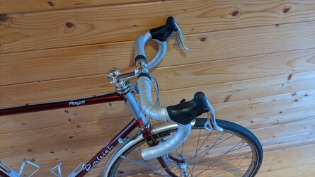

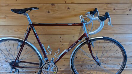

Hi all, just thought I'd add an update. I tried the bar-ends and they were really nice and smooth, but I ended up with some forearm pain where I was putting too much pressure on my left hand when changing - probably something I could have got used to, but I decided to go for Plan B.
So I bought some Campagnolo Veloce 9 speed shifters (old style) and they've worked a treat. I'd already changed to a quill adaptor/A-head stem, as the angle of the bars is now the same as my other bikes, and doesn't look too funky.
Thanks again to @Paul_in_France for the advice regarding 'shimergo'. A nice, simple and clean mod.

That’s a lovely looking bike.
