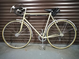

Perhaps the reflector has been put on the wrong end? In a hole that is intended for fixing to the chain stay bridge?
That was the final conclusion I came too. Not finished yet dut have the both roughly in position.

All the above (front guard needs to be fitted a lot closer to the tyre - benchmark: can't see through (from the side)).
For the rear, remove the reflector. When fitting to the chainstay bridge, use a nice big washer to spread the load and some thread locker on the bolt. Or if the hole is not tapped, use a nylok nut.
Check you have clearance between tyre and the bolt head, and if tight, use a flat headed or low profile button headed one.
You owe it to yourself and your face to get 'security clips' for the front stays.

Thanks. This is where I'm at.

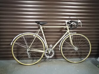

Forgot
Shortened the stays to take the guards closer to the wheel. Plan to disassemble and add thread lock to the stays. The problem was the reflector was on the wrong end of the rear mudguard.
Forgot to add pic.

is the bit circled actually attached to the frame or just resting?
normally it would be clipped or bolted to the bridge where indicated by the arrow.
That's just something I put in the hole where the reflector was to keep the end of the guard from flapping around. If I took the guard down to the bridge the other end would be in the wrong position. Too high up the wheel.

Its a lovely bike, it deserves better than some botched up, ill fitting (and dangerous front) mudguards.
