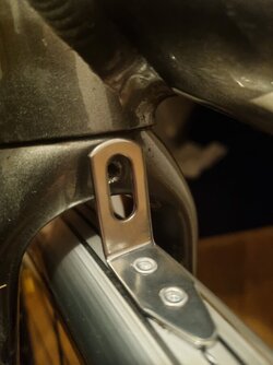

My solution for a bike with no chainstay bridge:
If you get SKS guards like the above Bluemels, the clip will slide to wherever you need it. You could cut off the angled bracket and drill the middle for a flat headed screw, then bolt the clip to the seat tube, so you don't need to drill through the guard.

Using chromoplastics I have spent the best part of a year with a guard without a seatstay bridge clip (ie just supported by the stays and bolted to the chainstay bridge). (Finally) the guard broke a few days before Christmas at that chainstay bridge hole. I cut the guard down with strong scissors to above the fracture/crack (obv) shortening the guard about 30mm. Then using a little augur pushed a 3mm hole through about 15mm above the new end, smoothed it with a round file just enough to get the bolt through and with a washer both sides (to spread load, normal practice but like the leather washer idea if I had clearance) secured it. Tweaked the stays - and fitted a metal seatstay bridge clip (the plastic one (per @Dadam 's image) supplied had failed after a year and worn the guard there too). But the shift of position (new hole) meant the new bridge clip could secure on a perfect undamaged section of the guard.
will I have to drill an extra hole in the rear mudguard?
I would see if I can use the current hole - the effect will be to drop the rear end of the guard by ?40mm (those on your wheel in the wet will thank you). If that's OK, fine; otherwise do 'exactly' this. As @MichaelW2, use a panhead allenkey screw to maximise clearance - looks tight in OP image.
