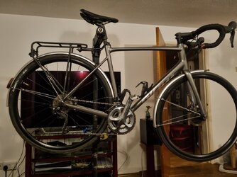

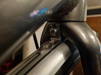

Mudguards installed, thanks for the reassurance everyone. The rear went on relatively easily, it did seem at first there wasn't enough clearance for the front (the 28c tyres that came with this bike actually measure about 31c), but I managed to work it out. I did have to go a bit neolithic on the front mount. I may put actual 28c's on it when these wear out. Anyway I'm happy with the look of it. I'll trim down the stays on the front guard (only just finished) when the sound of cutting metal with the dremel isn't going to upset neighbours so much!
I failed to mention that I also file the slot down by several mm (ie closer to the guard) to maximise clearance. Good job on cutting the top bit off.
A word of caution: the clearance might seem sufficient for the wheel rotation on the stand but you may find that, loaded, you've lost that tolerance. If so, use these "28s" on another bike and get a set which, inflated to xx psi, measure 28mm!
I discovered this overnight on D3 of my end-to-end (near Lancaster) after I'd had to replace a tyre with an hour to go. Was getting rubbing. Cut the bottom 6" of the rear guard away. Sorted. Till at 7am I rode out loaded (me and 6kg rack bag) to find immediatly the rubbing was back. Off wheel, off guard. Ride on (226km that day!)

Well, it survived a club ride, although it looks like I need to tighten the stays on the front guard :smile:

I’d stick a washer under the bolt head
Probably needs a little bit of thread lock. I'd also consider dropping the tyre size to 25c - my Trek nominally will fit 28s with guards but the reality is they rub like a bastard so dropping a size is needed.
I tightened the stays with plyers first time round, woops. Did a better job this time with a spanner. Just done another ride this lunch time and the wheels are running nice and smooth.
Washer installed too on the front guard's tab 👍
Two minds on this, for guard stays at the guard end. I don't because I expect to need to adjust occasionally. Use for the dropout fastener.
