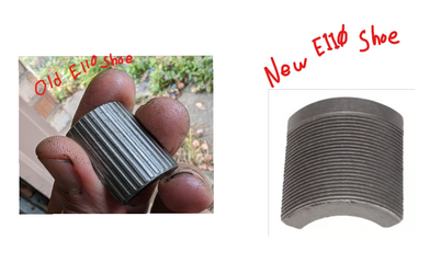

An update if anyone is interested. I was not able to find replacement shoes for this old Soviet bike. I purchased a used wheel (from local bike co-op) with same rim size and spoke count and with a Shimano CB E110 hub, and was able to lace the E110 onto the existing Soviet rim (bike owner wanted original rim on the bike). Braking was much better, but still not as good as I wanted. I then purchased replacement shoes for the E110. Interestingly, the grooves on the new shoes run perpendicular to the hub, as opposed to the old shoes (see photo). Braking with new shoes is considerably better.

In case anyone is interested, here is an update. I was unable to locate replacement shoes for this Soviet coaster hub. I purchased a wheel of the same size/spoke-count with a Shimano CB E110 hub and laced the Shimano hub on the Soviet rim (bike owner wanted the original rim). Braking was much better, but not quite good enough. I purchased/installed new shoes for the E110 and the braking improved significantly. Interesingly, the grooves on the new E110 shoes are perpendicular to the hub axis, while the old E110 shoes have grooves parallel to the hub axis.
