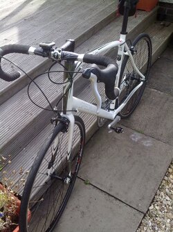

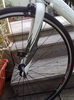

Thanks for the support guys, got the bike back this morning with all the visable damge at the front, buckled wheel, broken fork and damaged gear/brake lever.
Taking it into dales this week for them to prepare a quote for the damage.

I'd imagine with the trauma the frame has suffered from impact it'll be a right off!!! :sad:
They'd really need to strip the paint to test the frame properly for cracks - far too labour intensive. No shop / engineer would want to accept the responsibility of signing it off "fit for use."

looking at the damage to the forks, I would go for a new bike, I would think that the joints around the headstock will have been stressed, and could fail anytime in the future, just a thought.

Well as we always say the rider is worth a million times more than the bike! Glad you seem to be more or less OK but watch those bumps, bruises, aches and pains! Looking at your photos, obviously the forks are a write-off but I'm not sure I like your head tube - can't really tell from the photos but it may have got distorted. The bike shop will tell you for sure, if so it means a new frame and therefore probably a new bike.

Thats no damage its only a scratch, good for another 5000miles :rolleyes:
Seriously though, I'd push for a new bike thats beyond comfortable repair and think on the positive the bike/ car took all the impact and not your bones!

The head tube has definitely been damaged. On the photos, the gap at the front between the bottom cup of the headset and the tube is wider than the gap at the back which indicates that the bottom of the head tube has been flared = buggered.
New bike time.
