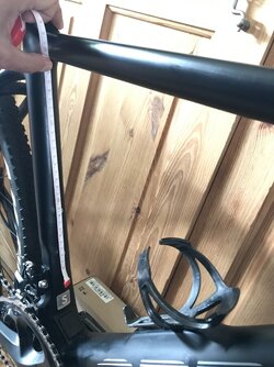

Hi I measured 26cm on a Small frame. I reckon it should fit, as the bottle cage can go lower. See how I measured it.
Your detailed information is so helpful.
Will the Largest Battery Size fit?! Photo enclosed. I started the measuring tape just below the lower bolt as the cage sits 2cm below the bolt so it should fit.
