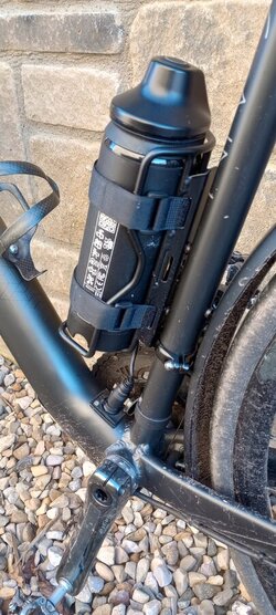

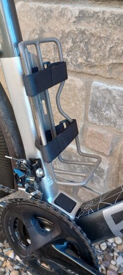

I found a solution:
- a Blackburn Outpost Cargo Cage
- it worked so well and IMO looks so much better than the awful plastic Mahle version that I bought a second one, and sprayed it black to match my Orbea Gain.

I forgot to mention that If you buy a Cargo Cage to use with the range extender you will also need to purchase a couple of longer straps - the ones supplied aren't long enough. I bought them from MDN Supplies. 400mm x 25mm.
