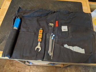

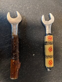

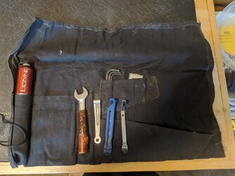

I have 2 tool rolls, each with a Lezyne pump, 15 mm wrench, 3 allen wrenches, park stickon patches, 3 tire irons and usually a section of paper towel for greasy hands. The 15 mm wrenches are cut down longer ones. Curremtly I have a 10 mm wrench and a screwdriver which has flat and Phillips options. No longer need the 15mm for my P line. I like to put Nuts, washers etc on the flattened tool roll so I don't lose them.
