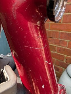

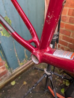

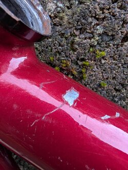

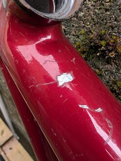

I was intending to build this Cannondale M500 up into a roadified MTB for my nephew. However, upon stripping the front end to rebuild the headset, I noticed this. It may be a scratch in the paintwork, or it may be a crack in the frame (which I need hardly add is Game Over for this particular bike). The frame shows no signs of accident damage and the crack, if that's what it is, does not show any signs of movement when the forks are wiggled about. What do you lot think?

Looks like scratches with a bit of corrosion running under the paint. Can you take a pin to some and dig any loose paint off to check ?

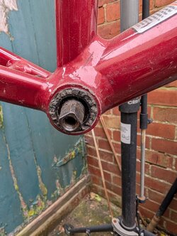

Well, that's annoying... The bottom bracket has some life left in it, but I'd prefer to fit a new one. And I certainly wouldn't be happy building this bike without sorting this first. I've always felt this splined fitting is a real weak spot of Shimano's square taper BB design. Anyone got any ideas how to shift this?
In a similar situation a heat gun was really helpful. It softens the plastics and I could remove the BB by applying force from the left side.

For clarification: The left BB plastic shell on that bicycle was stuck, too. So the only decision was which BB shell has to be destroyed first.
If you have the correct tool it's much easier if you also have a M8 fine thread (8x1) bolt and suitable washer(s) to hold it tight whilst removing. i sourced a couple off Ebay.
E.
It did indeed help, thank you. The non-drive side was an absolute cow to shift, but some heat and penetrating oil helped. Shimano's splined fitting is fine when these are new and properly greased, but holding the splined tool in place while trying to shift a bottom bracket that was fitted dry and has got a bit too comfortable in the shell is really tricky and means that stripped splines and skinned knuckles are always a possibility. The plastic shell used on the drive side is also a weak point, given that it's all too easy to do what whoever previously tried to remove this BB did and strip the splines. The whole design is a bit poo, to be honest. Anyway, it's out now and I'll be using lots of copper grease when I fit the new one.
I usually use a clamp, but you're quite right, a bolt would be better.

Avoid those left hand side plastic 'cups'. (Not applicable to this murdered (pre-ownership) one, but) the metal one from the BB you're replacing is a better bet.
I find a son useful for standing on the 20-spline tool to make sure it stays in while I use a coal hammer on the long spanner, till it starts shifting. One time must have taken about 25 blows.
