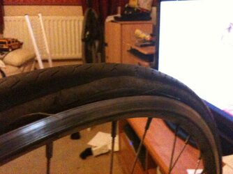

Hi all I have a road bike that has a bulge on the side of the front tyre. <br /><br />What can I do about this please?

Barnet,
