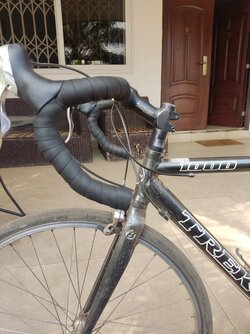

You might want to also consider aero bars. They allow you to transfer the weight from wrists to forearms and elbows. Something like this in the photo has some stack height built into it which might be helpful (I certainly find it helpful).
