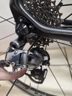

Rear derailleur i think its done
S
SQUIREJIM73
Member
11-28 cassette 10 speed.
Just pittibg cable through then align big cog at front smallest at back. Pics from side drive train side then behind.

I tried again pedalling using the correct large front ring and smallest cog at back but there comes a point when pedalling without cable in...when the RD wants to shift.."ghost" shifting i beleive.
So b4 I try cable...i surely need to make the RD is stable in just the one gear set up....I have a checklist to try.....

Three suggestions for your 'journey':
  • The chain length looks OK but check it goes large-large and the cage is pointing at 4-5 o'clock.
  • Screw in the H limit screw: currently guide wheel too far to right.
  • Once you establish RD is or isn't OK, replace cable: that has started to unravel where it's clamped. (Save for use as FD cable.)
When you say large large...do u mean large front ring to smallest cog at back i.e.biggest gear? O4 large front ring to largest cog on cassette.
I screwed in h limi screw
What i notice happening is the chainb comes away from bottom jockey wheel after a few gentle rotatioations of pedals. So stays within its houwibg but is not on the wheel at all..... hence this causes the seizing up....
If all this happened after it got knocked then something got bent. You replaced the hanger, OK. If the chain is perfectly straight then that should be ruled out, providing that you have no stiff link, that can happen and has been mentioned up thread. So then that leaves the derailleur possibly being bent or the frame. If it was all OK before the event, the limit screws and the b-screw should need no adjustment as they would not cause what you are experiencing, IMHO.
You the the b screw is bent out of shape.. itcwill not screw out or in.....and I dont have a hacksaw. Pmus worries about damaging the thread and then havibg no h screw option at all......H A LF O....
Ajax Bay
East Devon
When I said "large-large" I mean chain on large ring, largest (rear) sprocket.
Sorry not to be clearer :rolleyes:
I have still not seen the cable actually clamped in any of the many images shared.
Don't worry about the bent 'b' screw.
