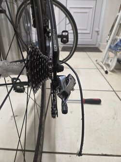

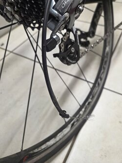

Rear derailleur i think its done
S
SQUIREJIM73
Regular
11-28 cassette 10 speed.
Just pittibg cable through then align big cog at front smallest at back. Pics from side drive train side then behind.

Three suggestions for your 'journey':
  • The chain length looks OK but check it goes large-large and the cage is pointing at 4-5 o'clock.
  • Screw in the H limit screw: currently guide wheel too far to right.
  • Once you establish RD is or isn't OK, replace cable: that has started to unravel where it's clamped. (Save for use as FD cable.)

I have still not seen the cable actually clamped in any of the many images shared.
Don't worry about the bent 'b' screw.
