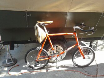

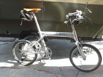

There is a huge thread on BikeForums on Swift folders and another one on a new steel Swift made by Origami Cycles. I have one of the aluminum Xootr Swifts which using few proprietary parts. The Origami one has disc brakes and seems to be a klo or so heavier.
As far as minivelos go Bikes Direct sells one called the Mercier periodically which is a little porky but not too bad, around $400, I believe. Velo Orange sells a much much more expensive one, named the Nano. All of these use 20 inch wheels and are normally equipped with derailleurs, although the Xootr Swift has track ends and can be a single speed if you like. The Mercier also has a lengthy thread on BikeForums.
I also have a Mercier which is fun. The Mercier, my Xootr Swift and my 2010 Brompton are all about the same weight but do not ride the same. The Brompton is for me the most comfortable by far while the Mercier, with a much shorter whellbase is the twitchiest. The Swift is in between. Those threads mentioned will provide a lot of info if you are interested. I found it interesting that all three were intended as solutions to urban commuting...Brompton for London, Minivelos for Tokyo and the Swift for New York City and all three have been used for many other purposes.
