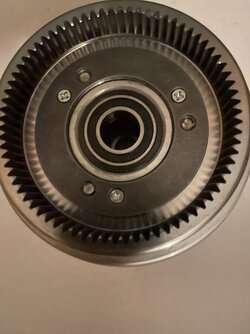

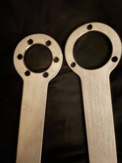

It's a moot point but if it were mine, I'd make my own spanners (at least have a try) but then I had access to materials, drills, welders etc etc. You'd be surprised what you can do sometimes...
I can see why the freehub is £80 to be fair, there's a lot of machining in that.
Putting some perspective on it, I'd say your potential loss of £80 for 5,000 miles use is pretty good value at 1.6p / mile cycled.
Even if you add in the cost of the tools, it still only comes out at circa 3p per mile
It's disappointing, but I'd swallow it and move on.

I sure am, I bought a Clarks chain for the Raleigh in January and it broke in January, I used a quick link to get home and planned to replace it, but the Ribble arrived and I forgot.
Back on the Raleigh and on Friday (8 days ago) the chain broke again, both times on a normal link not a quick link, so I was off at a very slow speed, it was then that I remembered that I needed to replace the chain.:laugh:
I don't blame Ribble for the choice of components, I knew what I was buying and despite many votes for 5,000 miles being okay, I am still bugged by their indifference. Don't forget that they are still selling X35 equipped bikes today.

.... It's a moot point but if it were mine, I'd make my own spanners (at least have a try) but then I had access to materials, drills, welders etc etc. .......

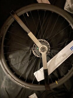

I have become a modern middle class person without a workshop and the tools necessary to make them.^_^
I don't really have any choice do I?:smile:
But this will make it an expensive month,
£140 hub and tools
£118 - 3 new Inner tubes (oh, I did also get a Lezene light, some tyres and something else)
£58 - 6 spokes (4 more inner tubes and a new set of pedals)
Most months seem to be like this, something that is only 1p or 2p mile needs replacing.:sad:

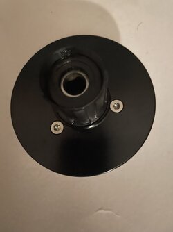

From the opening post and ref the consumable part exclusion.
"you don't seem able to replace the just freehub as it comes with the motor outer plate"
By making the unit so the freehub is intergral with part of the motor you could not unreasonably argue that it has ceased to be a consumable part if it is impractical to replace it and furthermore it is an intergral part of the motor assembly and there has to be covered by the warranty.
Again sadly, I'd disagree.
It requires tools to replace, so does just about everything. We don't complain because we need special BB tools ?
It is a consumable part... it wears out and requires replacement. Expensive but consumable.
It's not impractical to replace, (it actually looks quite easy to replace...Once you have the tools. But yes its expensive to replace.
You could argue the same about any premium car, the costs of specialist tools and complexity go up. Its a sad reality, we don't get to know the shortcomings of a particular design until its usually too late.
Don't get me wrong, I sympathise with the OPs situation, we just see things through different eyes.

For those unfamiliar with the X35, here is the "freehub" as sold and the spanners and please don't ask me why they don't sell just the freehub.
