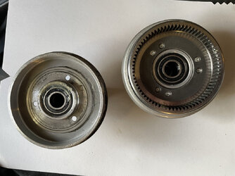

I learnt something this morning..... there are at least two types of freehub body for the X35.:laugh:
The one on the left is what I have and the one on the right is the one that I ordered. They are different sizes, so I can't just use the new one.
Sadly I needed the tools to know this, I couldn't take old hub off until they arrived, so maybe I should have ordered the tools first.

I feel your pain Ian, nothing more depressing than getting that far and...oh, bugger.
Look on the bright side.... You may have found already that the only problem was sticking pawls (fingers crossed), you can return the unused part for a refund (or the correct size if needed), and still have the vital tool to take it apart next time when or if it sticks/breaks again.

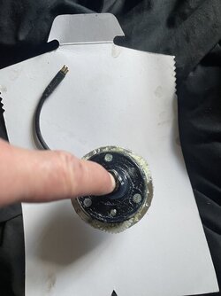

I'm puzzled by your picture. Have you unscrewed the planet ring from your original?
As we all discover too, next time the job will take a fraction of the first time.

Good morning,
I'm puzzled your picture. Have you unscrewed the planet ring from your original?
I eventually worked out what I had done. You have to remove three screws on the the freeehub+plate to attach the spanner to undo this from the hub, if you don't replace these screws the freehub+plate comes off leaving the the toothed outer ring still attached to the motor.
What you should see after taking the plate off is this.

I thought that the supplied replacement part had changed, when @Dadam mentioned the X35 and X35+ it was obvious as the same part is a replacement for both of these.
It is a really trivial task once you have right tools, although oddly the spanner length and the wheel radius are the same, this means that the jobs takes a bit longer than it needs to as you have to stop to put a plaster on the finger that gets trapped between the spanner and a spoke.

As you can see from the left hand photo on the previous post there is no way to get at the pawl mechanism, at least not on a part that you intend to reuse. You may be able to spray LPS etc through the "sealed" wheel bearing and I will try that, but what it will do to that bearing is a mystery.
