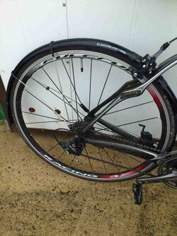

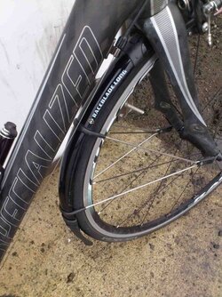

I have a Roubaix 2010 comp running 23mm tyres and the Raceblade Longs are brillant
