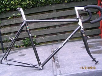

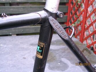

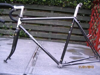

Meet 'Sally' the third addition to my family of cycles.
As you can see from the pics, she's in need of a bit of TLC, and that's exactly what she's going to get.
Over the coming months i'll keep this thread updated with my progress...in picture form..of course^_^
I have set myself a deadline for completion by Spring 2014, though i hope to get her finished before that, funds permitting.

I acquired the Randonneur frame this week, complete with seatpost, h/bar stem, bars and canti brakes.
The seatpost and brakes are original to the bike, the bars and stem are Sakae Royal which is authentic to this model and year though not from the original bike.

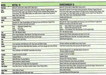

After a bit of digging i have found out the bike is an 1987 model, built in August of that year in Nottingham.
I have found an original Raleigh spec sheet for that model year and will be searching around for authentic parts over the next few months.

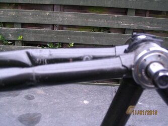

The paintwork is tired but reasonable but you will note from the pics there is some damage to the rear of the BB on the chainstays. My best guess is that a previous owner had a V stand fitted to the bike and whoever fitted it may have been a little over enthusiastic with the torque wrench^_^
Current plans are to get the damage checked out and if necessary have it repaired, if the damage does not affect the strength of the chainstays then it will be left as it's part of the bike's history. At some point it will get a full respray and new decals.

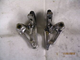

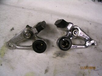

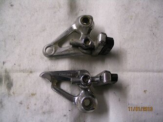

Spent an enjoyable couple of hours this afternoon in the garage, stripping the canti brakes and attacking them with my Dremmel and a tube of Autosol
The results are unbelievable....here's one cleaned and rebuilt and one not!

One thing that you may be able to help with, on the spec sheet the wheels are listed as Mavic M3CD rims laced onto maillard 600 hubs, lots of google searching has produced zero about the rims, any info about those would be much appreciated.

have been doing a bit of research about the rims and still nothing on the M3CD, though the MA40 was widely used back then so maybe Raleigh used OEM MA40's.
The rim you recommended is the current version of that rim, so looks like i have a choice authentic MA40's @£60 each (NOS) or modern day equivalents @£30 each...........decisions decisions:unsure:

Had the 8 speed UG cassette removed at a LBS ( i don't have enough arms and hands to remove Uni Glide ^_^) who is a Raleigh dealer, so quizzed them about the Sachs Huret Derailleurs on the 87 model vs the Shimano Deore DX fitted to the 89 model, they warned me about the sachs breaking too easily (which is why Raleigh switched to Deore Dx) so am probably going to go with Deore Dx.
Asked them about the Mavic rims too and they told me the M3cd &M4cd rims were entry level rims OEM for Raleigh, they recommended Mavic Open 4cd's (vintage) or Mavic A319's (current).
