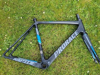

Mburton1993
Stalybridge
I bought this second hand carbon frame last April, I've done 1850ish miles on it so far and so far it hasn't split in half. Although I did scratch the paint work in Liverpool last July, that was annoying.
