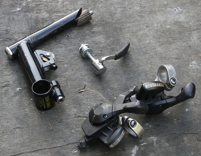

I've an 8 gear setup (on a dawes Tamarak) and it feels like the selector on the handlebars is dying.
I can't find them for sale new, any ideas what I should replace it (and the 3 gear one) with?
Was going to replace all the cables at the same time, get it nsorted properly.
Nige

This one has been stiff since I got the bike (second hand, 9 months ago) and I've done a few hundred miles since then.
Two evenings ago, I felt something give, now the change up lever wobbles sideways, the whole thing is moving much more easily, and I've a feeling that something has broken.
So, plan was to take it off, replace cables, strip/clean the changer, but I'm expecting to need bits at the very least. Thing is when I find a bit of time to do it I'll have newspapers all over the sittingroom carpet, bits everywhere etc, and I would really like to at least stand a chance of fixing and re-assembling everything, so I can get back on the road.

It used to be possible to buy just the shifter pod. That's the best option if you can find one.
Nine speed shifters will not drive an eight speed cassette but forget about gear compatibility for a minute. As STX RC it's highly likely that they are STI (Shi**no Totally Incompatible Integration) which means the brake and gear levers are on one handlebar clamp. Which means you have to replace whole lot, not just the shifter. STX RC integrated shifters are cantilever compatible, ie not compatible with modern linear-pull ('V') brakes. Cantilever brake levers will not drive linear-pull brakes. Since Shi**no hasn't made a cantilever compatible STI unit since 1996 you'll be buying linear-pull compatible units so if you go down this route you'll need to replace your brakes with Vs.
The option of fitting 9 speed shifters is a good one if you just happen to also be in the market for a new cassette and chain. And chainrings. But again you'll also need new brakes. Time for a new bike?
If you cannot find eight speed pods the least worst option in my view is to take a hacksaw to the brackets which attach the pods to the brake lever body, file it tidy and fit a regular pair of eight speed shifters.

These say Shimano on them, and the gear and brake controls are seperate - ie 4 clamps onto the handlebars.
Brake handles work a treat, don't particularly want to change them, but will do if I have to.
Don't really want to look at the cost of a new bike for the sake of a gear lever??
I'm now really confused!
Nige

Ok looks to me like there's more than one Tamarak by Dawes (or mine has had non-standard kit fitted).
http://homepage.ntlworld.com/team-triplet/TTimages/2004/P5166377.jpg
looks just like mine.
The gears and the brakes are held on by their own fixings.
So, sounds like I need a lot more info on what I actually have, how do I find out? Somehow, I think this Saturday will be spent cleaning and photographing, rather than fitting replacements!

A better piccie here :-
http://i141.photobucket.com/albums/r77/hilarystone/3t-Campy-seat-STX-STI.jpg
MacB
Lover of things that come in 3's
Nige, the combined brake and shifter pod on the link should work fine, as long as your bike has v-brakes.
Maybe take a picture of the bike in detail and we can verify for you
