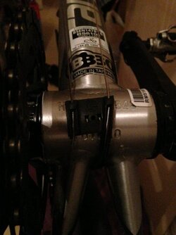

I thought bikes had little drain holes in that area to let any water out? Might be wrong - haven't looked on mine tbh.
Excellent point. I actually checked with the bike (same as @Nomadski) on the stand and there is a little whole underneath the BB for this purpose. It is tiny though, maybe 1-1.5mm in diametter and I would expect it to get plugged quite easily with road grime. Very important to ckeck and unplug this after every wet ride.
Holes? Under the BB area? Where?

So tiny no wonder you couldn't find it :smile: I inserted one end of a spare brake cable in there and it goes inside the BB and hits the cranks. This must be it's purpose.
BUT that being said, in your case it looks like you converted to BB30 to a Shimano BB, most likely using one of those adapters that fits inside the BB. This might have covered the draining whole and cause water to accumulate. Not sure what is best to do but if it was mine, I would remove the BB and drill a whole through the adapter to make sure there's a way for the water to come out.

I don't think those are holes to drain water but I could be wrong. I think the hole is there to screw the cable guide into. I don't think they are meant to get water in there to start with.

Like @RWright said, that hole is only on the black plastic bit, which guides the cabling.
I think the hole goes through into the bb shell or whatever it is called, you could just take the screw out once in a while to let it drain if you have been riding in rain. Make sure you use grease around the bearings that go flush against the bb shell, the grease and the seal are supposed to keep water out. I think water can get in by the seat post and maybe even the water bottle cage mounting bolts too. I put grease in the bottle cage holes but am not sure what can be done about the seat post.

That was what I was thinking. I don't know if they just drill them all out or what. You don't have a cable guide on yours?
Yes, there is a cable guide, actually, apart from the colour, my bike is the same as @Nomadski but with the original BB30 bottom bracket. I think the cable guide clips inside the frame's hole but I can be wrong. Can't think of a reason for the hole in the plastic guide unless there was a screw in there and I lost it somewhere on the way.
