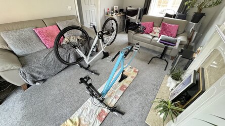

I’d like to think I really noticed the difference after stripping, cleaning, lubricating and setting up bearings of the Trek MTB. If only in my fairly anal head.
So I’ll be doing the Trek Hybrid tonight. I know I’m extremely particular; but it’s wrong isn’t it. Both rears especially are tight, slightly graunchy and I’d suspect again - completely devoid of grease from Brand New.
I emailed the supplying dealer Friday asking if I needed to deal with them as supplying dealer. Or Trek themselves ref my concerns over this issue. And rectification of course ! Which in no way should fall upon my shoes. No reply of yet…….🙄

Trek Hybrid FX Hybrid wheels also duly stripped, cleaned, lubed, bearings adjusted and re-fitted:
While the design and Trek components on this bike may be great: the attention to detail / build quality / PDI from them or supplying dealer is nothing less than horrific. **Ok - I’m an Engineer and more particular than most….
But - what chance of longevity do components stand: when nothing but nothing had a single drop of oil / grease / lube etc on. Coupled with being overnight in the case of the cone bearings on all 4 wheels. It’s brain dead and nothing less.
Still. At least now the wheels do go round 🙄 I’m guessing I’ll gain some speed. Or as we’re all basically lazy arses……save some energy to do the same speed 🤣

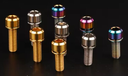

Needed (Ref wanted some nicer…..) slimline headed M4 Bolts for my lock-on grips. With a much smaller cap-head diameter than standard: or is readily available.
Luckily found some in Titanium. And price wasn’t too bad only being 8 x small bolts i “need” (M4 x 13.5mm). I can see these being addictive though……
