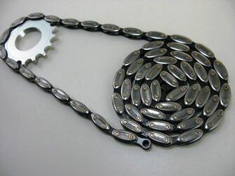

These look good.
Sharpy
Active Member
These are pretty smart for a single speed commuter. Haven't heard much about them just yet but they do look good :biggrin:
