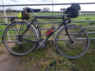

It looks to be a few inches higher than yours, I reckon - looking at the photo (bike is not level - I don't have many "illustrative" photos), there seems to be about three inches or so between the stay mount and the mudflap whereas your stay mount appears to be directly above the mudflap. I also noticed that the mudflap is folded backwards against the ground in the photo :rolleyes:.
Thanks - that certainly looks in keeping with the older variants I've seen. It seems that there are at least two different stock images of these guards being used by online retailers.
From SJS we have guards with the earlier stay positioning (and fixings):
..while wiggle are using a more up-to-date image:
This is one of the reasons it took me so long to source mine; as the well-priced retailer I'd found was still using the old image and I was concerned that they were cheaper because they were old stock.. which thankfully turned out not to be the case :smile:
I also found the Bike Rumour review I was alluding to; which mentions this difference and was apparently published in 2018 so the timeframe fits.
You might be less inclined, but personally I'd be dropping SKS an email noting the design change, the fact they're just out of warranty, expressing your sadness that the guards hadn't lasted as long as you'd hoped and tacitly begging for some warranty replacement :tongue:
