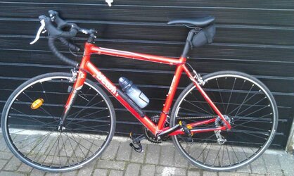

As for the fit. He took one look at me and said I wanted the 57cm frame. That was it. I'd already swotted up on YouTube videos and assumed I could do the finer tweaks. Maybe i should have made a fuss but tis done now.
I looked at MTBs and hybrids but wanted a proper road bike to do the ride London 100 on in august. I'll flip the stem and see what it feels like. I've discounted the one in the link as too short but could try something less extreme if need be.
The bike does not feel massively out. But a slight adjustment might give my wrists a break.
I used to ride motorbikes so I think my road sense isn't bad. But the brakes don't bite hard enough for me to cause a skid, so its not a tyre issue. Its probably a knackered weak ass wrist issue rather than the bike. Am seriously considering the cross levers
Lanzecki
The guy at decathlon said the stem wasn't angled so flipping it would not make a difference, but he was gone in a nanosecond so I'm not sure I trust this opinion. Thanks for the feedback on the stem I posted. Maybe a bit short. I'll measure up my current one.

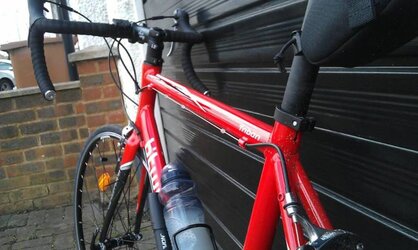

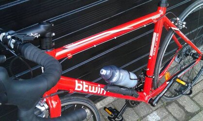

I think they are angled, but a picture will show us. Time to post a photo!

Its not as if you've never seen one before!

Just flipped the stem and it has made quite a difference. My 57cm bike had a 100mm stem. Will check it out on a longish ride tomorrow and see if I need to buy an 80mm.
