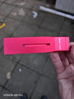

I use a large flat screwdriver and leave the old pads in place. By a combination of levering and twisting the blade I can get the pistons all the way back in with no fear of damaging them.
I used to lever the pistons back in using random tools but I have 3D printed a couple of wedges that makes it far easier and more controllable.
The small wedge is for where access is restricted. The coin is for scale - I'm not printing those yet.
