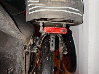

I have a light attached to the top of the arch.
Is it possible to post a picture as I'm curious to see how you have done it, thanks in advance.
