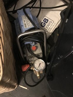

I gritted my teeth and bought a Kranzle, but it was an awful lot of dosh, even buying direct from Germany (no longer viable as VAT and fees are now added). They are even more expensive now. For context an adjustable lance for the Kranzle cost about the same as one of the cheaper Karcher machines ! The kranzle lance is mostly brass and steel so genuinely a vastly better thing that plasticky ones.
Anyhow it is an outstandingly good and powerful machine. Mine's their 10/122 but in retrospect I'd buy their very similar 7/122 which can use water from a container rather than needing mains pressure; not that I've so far needed this ability, but it could be handy, and the slightly reduced litres-per-minute (7 rather than 11) would be no great loss, and perhaps more manageable. You can wind back the pressure but not the volume. Mine does not have the auto-stop-start feature, which is yet more money, and appatently not a benefit for home use where you don't leave it "idling" as it were
One thing they do on cheaper washers is have a kink in the lance. This gives a sideways force which makes the user think the machine is more powerful than it is. They don't do that on pro machines as power is not in question but straight lances are easier and less tiring to hold
As with a lot of things industrial or trade level kit is usually a lot better than DIY grade, albeit sometimes a lot more money. These days some DIY grade stuff is quite poor - not maligning Karcher here, but when you see an angle grinder or whatever for a tenner it is clearly going to be crap as making something decent for such a low cost is just not feasible.
Anyhow, despite the cost, I don't regret buying my Kranzle machine, but I see they're £600 to £700 now, which is a lot
