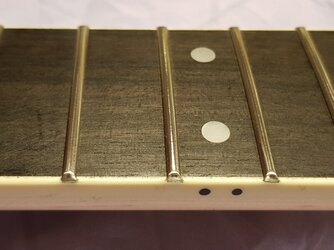

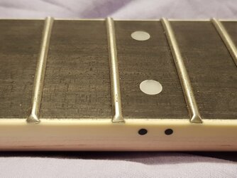

Spent a pleasant evening cleaning and polishing the frets and they've gone from this
to this
They're feeling much smoother under the fingers now, that's a job that definitely needed doing. Also put a straight edge along them and couldn't see any obviously badly levelled frets so I'm feeling optimistic.
to this
I’ve been doing the same, no pictures, but like you found them level, but just a bit sharp, I’ve also sanded it and treated with boiled linseed oil, and cut the headstock as well.

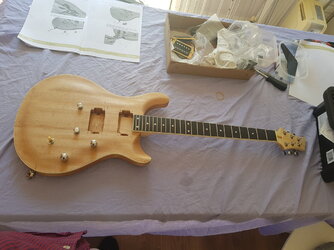

Breaking for lunch so here's what we've got so far.

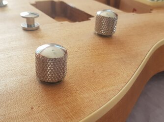

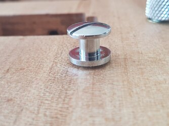

A few things to note. Firstly I decided I couldn't live with the finish on the body so I've sanded it down and given it an oil and a wax. It's not gonna be the most durable but whatever, it looks alright for now. I shimmed the neck joint with a bit of old cereal packet so that's nice and snug now. The bridge posts are sitting about a millimetre proud of the body, ideally I think the post holes need drilling slightly deeper but I don't have the time or the inclination. Likewise, don't look at the pots too closely, they don't sit nicely against the body but that's no surprise.
I have drilled out the channel for the pickup connecters and deepened the routing for where the pickups sit so that should all fit now.
Yup, instant Bender Snapocaster!
Id advise a nice Hercules stand, but it'd be worth more than the guitar! :biggrin:

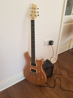

Looking nice. I like how the binding stops at the cutaways.
The binding actually sets it off quite nicely and stood up surprisingly well to the aggressive sanding which was needed to take the sealant off. It plays really nicely too which was a pleasant surprise. It's light so it's not going to win any prizes for sustain but that means it's good to throw around and give to a kid. The tuners are terrible but the action and intonation are good. Switches pots all do their job with no noise and I managed to get a nice bright tone out of it which I quite liked but it took a bit of fiddling with the gain on the amp. I expect I'll need to adjust the pickups although I haven't had adjustable pole pieces before so that'll be interesting.
