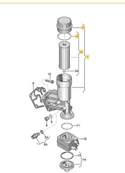

Anyone know where the engine code is on a Skoda Octavia 09 TDI?
Cannot find it anywhere and it's needed for getting correct oil filter 2.0 (140)

Sorry, not off-hand, & my Kodiaq has the same engine (2.0TDi/140BHP)
No luck via the Europarts/etc....websites, using their 'via registration plate' search?
It looks to be a cartridge, to fit in an outer-shell

Usually on the cambelt cover on a barcode sticker or send me the reg and I'll let you know
2.0 140 should be a BKD engine
Looks like BKD's use a paper cartridge

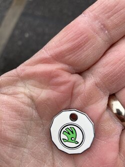

For those wondering, it's a shopping trolley token
EDIT @ 19:55
I have no idea where it came from, I wouldn't have bought such a thing
I can only presume that it was;
1. a free gift, when I had the Octavia, as it had a few main-dealer service visits, when we first got it
2. from my fathers Fabia, when I emptied it, after his RTC, throwing it all into a couple of black bags?
EDIT @ 19:55
I've got the same thing on my Yeti keyring. Can't think if I've ever actually used it but it's been there for years.
