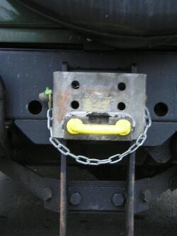

The adjustable height set-up on my 110 ,with a towing ring on the spare slider
641010
Sockets tucked up nicely out of the way, on the Discovery 300Tdi (it was a 50th Anniversary)
641011
641012
