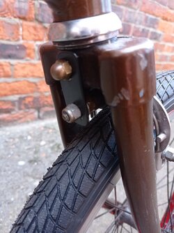

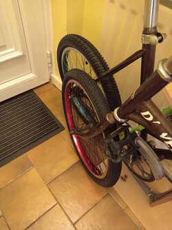

No, I have opted to file out the fork slot (only low side + razor blade clearance!)
I will wait for the tyre (*Saturday) and then mock up the Drop Plate dimensions ๐Ÿ˜ฎ
*Tyre arrived Thurs ๐Ÿ‘

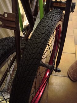

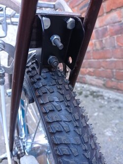

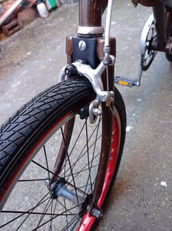

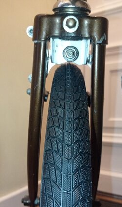

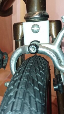

Right Ho! NOW we can measure up for the front brake caliper Drop Plate ๐Ÿ‘Œ
LardAbove ๐Ÿšด

Drop plate cut & fitted. Needs to come back off for painting... Quite a tight gap, onto the tyre, but I'm sure I will survive ๐ŸŽฑ
*tyre on wrong way = only on for clearance ๐Ÿ˜‰

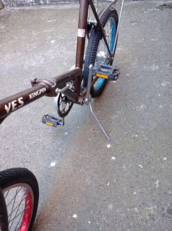

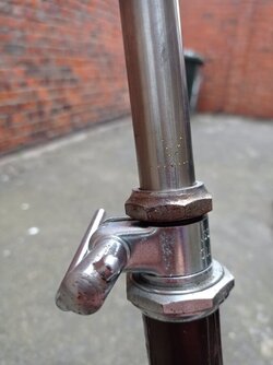

Replaced my 'tired & deformed' quill clamp [25.4]..... It takes the chromed lever/wingnut, as original to my Kingpin.

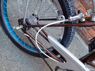

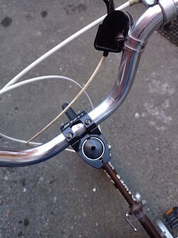

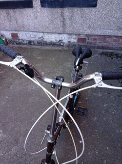

I elected to replace the rather clunky handlebar clamp with something a little more elegant.....
All set & clamped up tight.... Just need to run my brake/Sturmey cables and Hit The Road ๐ŸŽ‰
Bit of a marathon.. timewise.. but I don't have a garage/shed/mancave ๐Ÿ˜ฎ
I will get a YouTube up ๐Ÿ‘

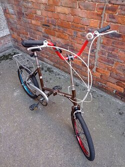

Finally..... Ready 2 Roadtest ๐ŸŽ‰๐Ÿฅ‚
LardAbove ๐Ÿšด
*so pooped in this heat, so wobbling will have to wait till tomorrow ๐Ÿ˜ต

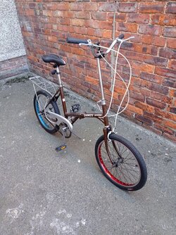

Tyneside
........ AND ...... We have had a shot around the block ๐ŸŽ‰๐ŸŽ‰๐Ÿ†๐Ÿ†๐Ÿ’ž๐Ÿ’ž.
You wouldn't think it was the same* bike!!

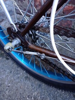

Soft as marshmallow, through the fat tyres (Oh Joy, in the Bum dept. ) The SA is like butter >> clicketty click.. Up>Down>Up>Down & sweet spot adjusted straight off the bench.
16T sprocket (down from 18T) has dragged the gearing into the 21st Century = now I have Hauling 'Low'... To the shops 'Mid'... Leggy 'High' ๐Ÿ˜Ž
Can't wait to get back onto Hadrian's Cycleway for a proper run up. Absolutely Delighted ๐Ÿฅฐ

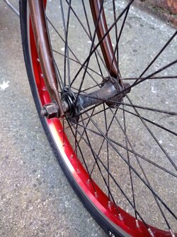

Tyneside
..... I think we know what will match the front ally rim, perfectly ๐Ÿ‘Œ

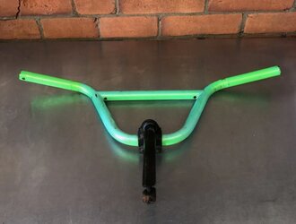

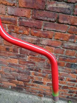

Tyneside

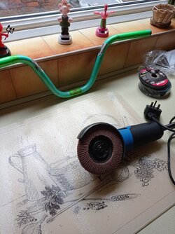

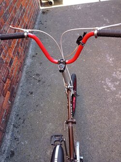

Right Ho!.... ๐Ÿ˜‰
Handlebars arrived just this morning. I dived into my 'man cave' (cupboard)...
#1 Cut out brace
#2 Linish off weld bead
#3 Dress flat, to pipe bar radius, with Flat file.
This bar is a 6inch riser.
As it is rainy I cannot go outside and lash on my Lidl grey paint.
I have decided against buying a can of red... I have ample supplies of Auto Matt black, so that will be the ultimate finish.
*rubbing back between Lidl coats ๐Ÿ‘
ยฃ10 well spent, I reckon ๐Ÿ˜Ž๐Ÿฅ‚

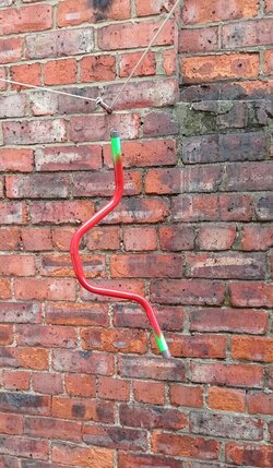

Tyneside

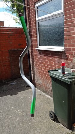

After all that, the black is not compatible with the undercoat...
Back to the Red๐Ÿ‘
Still some reactioning under the red, a quick flat back and have another go ๐Ÿ˜‹

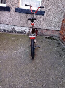

LardAbove
LardAbove
Tyneside
Ready 4 A Rumble ๐Ÿ‘

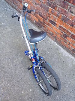

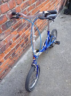

As seen, in my other thread......
Looking forward now to trips out, just chuck in the back of our car & GO ๐Ÿ˜Ž
