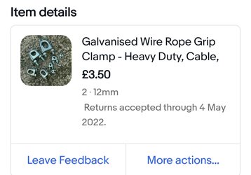

Pulled the trigger on these 'u-clamps', after much thought.....
The upright is 12.8MM but, with judicious filing of the U [creating a flat land to grip] and a plate holding the V-brake pins = plenty of opportunity to jiggle critical dimensions + no braze/welding ๐Ÿ”จ๐Ÿ‘.

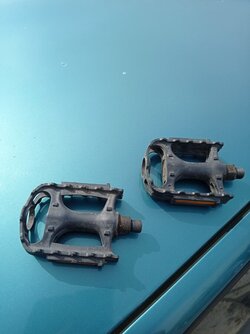

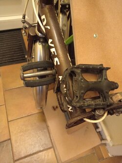

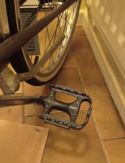

Visiting our local Civic Amenities Dump, to offload some shizz, I eyeballed a stack (..60 odd) scrapped/weighed in bikes.
A quiet word, with the 'on site shop' operative, had me liberate a pair of pedals ๐Ÿ˜Ž
Freebies..... Just on my 'price point' ๐Ÿ‘Œ

Cleaned out the ball races, on my freebie pedals.... All Greased Up & Ready To Roll!

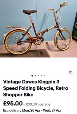

The SA 3sp hub I bought (36h) to swap out for the 28h already on it, is nice and clean & quiet.
I contemplated undoing the cones and refilling the ball cages but - then again NO!
I had in my oddments box a 'blunt' hypodermic needle jobbie [for injecting re-used ink cartridges] so I filled it with axle grease >> injecting the grease directly into the gap around the cone.
Happy with outcome = all the grease went in the balls! ๐Ÿ‘Œ

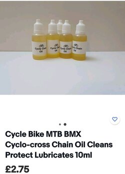

I have been reading on various 'bike forum', derived from Googling "what is best bike chain lube...?", that.... Incendiary!! ๐Ÿ˜ฑ๐Ÿ˜ฎ.
I'm not really... Err, 'into' heavy tech, around this ๐Ÿ˜ต
3-in-1, rubbed around slowly backspun chain, is going to see me out ๐Ÿ˜‰๐Ÿ‘Œ

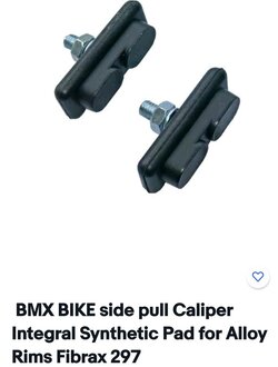

As the 'scrappy' V-brake I got, from eBay, were worn out...
I have bankrupted myself a pair [rear only rqd!] of Snazzy NEW brake blocks...

Given I'm keeping the chrome front rim - atm!
I though a fresh pair of brake blocks, to compliment the rear setup, might be cool....
Fibrax seem to be the buzzword ๐Ÿ˜‰
