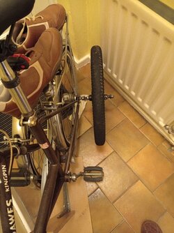

I have been weighing up tyre choices....
500 (440mm) are few and far between, though you can get 'all black' rubber.
Raleigh 20 (451mm) wheels have more choice of suppliers and tread pattern.
BMX origin rims, I read, are wider and you can go for 'all terrain' tread (but they may not fit frame gap).
What are people's experience with changing rim size (... away from Kingpin 500)?

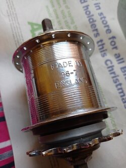

...... sometimes you just can't help yourself 😜

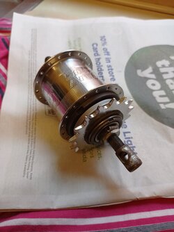

£5 and just along the road!
36hole SA 3sp being sourced.... £13 Sorted!

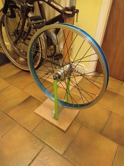

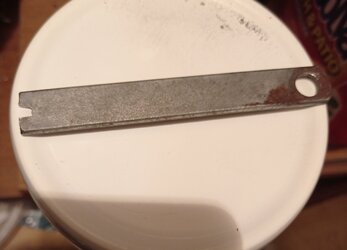

Would anyone be interested in following my 'restringing' this BMX 406 with the 36h SA?
I have measured the fork/frame gap, at the crank (to clear this tyre width) and the frame is 55MM and the tyre 50MM (option for a narrower tyre, but loses rolling dia!)
I will look into spoke length but I reckon the ones here may be suitable to 'go again' 👍
*needed a 'nipple spanner', so I notched the end of a piece of 1/8" plate with my hacksaw = sorted!

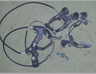

I have taken a 'punt' @£3.....
Should be able to cobble some Deceleration Potential from the bits....
I am also constructing/fag packet design for attaching the 'pivot post' (I have no welder!)

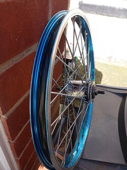

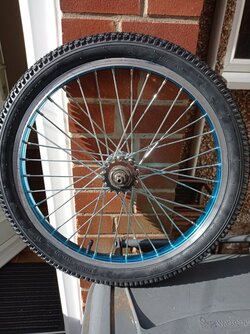

OK...... My 406x25 is laced/trued & tightened....
*My 'nipple wrench' was cheap enough >> £0.00
