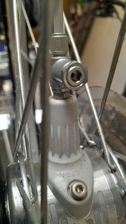

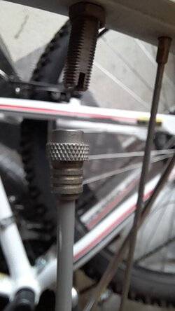

On pulling back the rubber, it's completely sealed! I have tried using presta pump on the opposite end, and it leaks. That piece fits in the gap in the second photo and the 3rd photo is the hub end. I think I will have to resort to swapping out the tube and forgoing the air hub. I emailed Nakano Air hub for help but no reply. Can't find any videos either on how to inflate from flat.

:welcome: Way 'left field' @susans suggestion/question: have you tried fitting it up, putting the bike on a stand and rotating the wheel? It should pump the tube up to 42psi (the design limit).
Well that idea had crossed my mind and after chocking it up in the air and after several rotations and not a sausage wondered how long it would take from flat....I will give another go. Although after peeling back the rubber I tried twisting it to see if it unscrewed the other end and now damaged the rubber but I could try it with the other wheel. :smile:
Ajax Bay
East Devon
Best of luck. The capacity (pump in hub) must be very small compared with the internal tyre volume so I'd be looking at hundreds of revolutions from grade.
