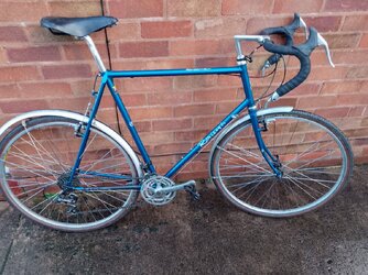

Finally found time to complete a Raleigh Randoneur refurbishment. The whole bike cost me peanuts. It was destined to become landfill. My size (25" frame), Mavic wheels, Continental touring tyres, Reynolds 708 tubing, selection of Deore LX components, bar end 8 speed shifters, Campag headset, Sugino triple crankset, and a Brookes B17 saddle. Peeing down when I finished it so hoping for first ride tomorrow.
We'll want to see pictures...

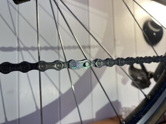

Also thinking about how I’ll connect my new, incoming chain together. I MAY start Hot-Waxing this year - so could do with a way of making the chain easily removeable. I have a ‘missing link’ for a 6/7/8 speed. But I think these are supposed to be single use - and are £4 odd a pop for genuine KMC. Old fashioned ‘Split links’ seem to be hard to buy now. I think I may have one to fit though…
What does everyone else do that regularly removes chains to lube / wax / clean etc ?
I just break them using an old fashioned chain tool, then re-connect them when I'm done. I've never had a problem with doing it this way. I've never used one of those fancy quick links, they seem like a crude way of doing the job and if they're supposed to be single use then you still have to push a rivet out of the chain to put a new one in anyway!
I'm never without a chain tool though, you can get round flat tyres by stuffing them with grass or even riding home on the tyre alone ~ but if your chain snaps you're knackered.
lostinthought
Cheers ! I really meant ‘What do people do in terms of regularly removing the chain’. I take it you don’t therefore. That’s another option I guess…..strip of oil when new, wax or clean and re-wax on the bike as you go after that…..
I've used quick-links for years to remove chains regularly, and just replace them when they feel like they come apart too easily, regardless of any claims about single-use. I'm no fan of wax, but always remove chains for cleaning. I have a bunch of KMC links for another 10 speed bike, but I'm currently using SRAM flat top links for my Campag 12 speed chain, I bought a few of them but am still on the first, I think. Grubby bike pic alert..!
Thank-you gents. I’m sure I read about the quick links being ok for multiple uses too. Ass-covering manufacturers no doubt 🧐
