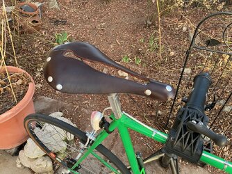

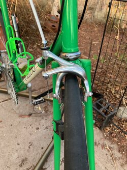

Installed my new seat and a mongrelized Campy front brake caliper on Fredo. Filed down the slots to get 2mm more reach, then used my older Record brake blocks with Kool-Stop pads with the newer Record dual-pivot caliper. Learned the newer calipers don't have a quick-release! Was Campy back-sliding? Although the seat is more for looks, I wanted to be able to brake effectively from the hoods.
Next up: Suntour bar controls to replace the stem-shifters. All to give myself an advantage riding around here:
