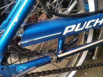

Some fettling on my Puch Promenade. It was kindly donated to me a couple of years ago from my brother, and came as a single speed.
It is now a 3 speed, and all the parts were to hand thanks to my hoarding tendency when it comes to bike stuff.
Tricky bit was the cable end clamp that only just fitted in the right place, as it was right up against the mudguard clamp.
I do like those old one piece gear cables from vintage Raleigh Shoppers etc - so much better than the more modern over engineered offering.
